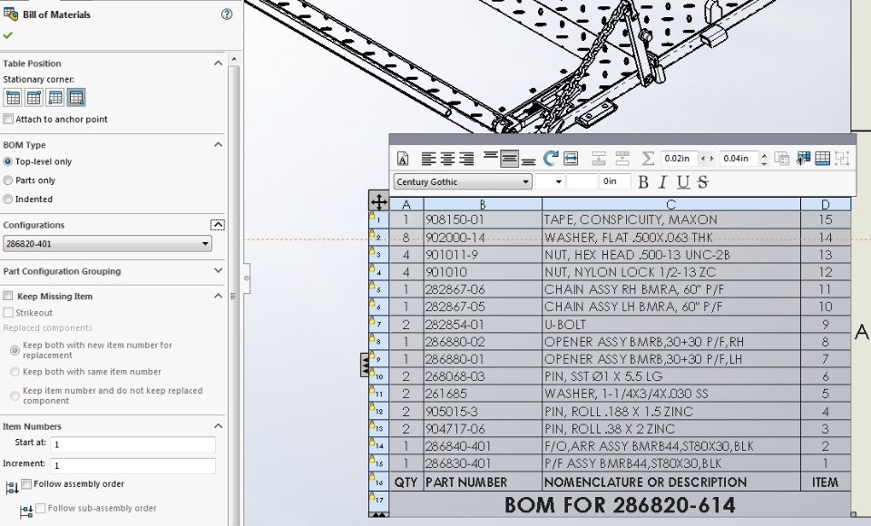

The BOM is inserted with the Configurations Part number as the Title Matching the Drawing View Configuration.
But for some reason. The BOM itself configuration dose not match.
It defaults to the first configuration.

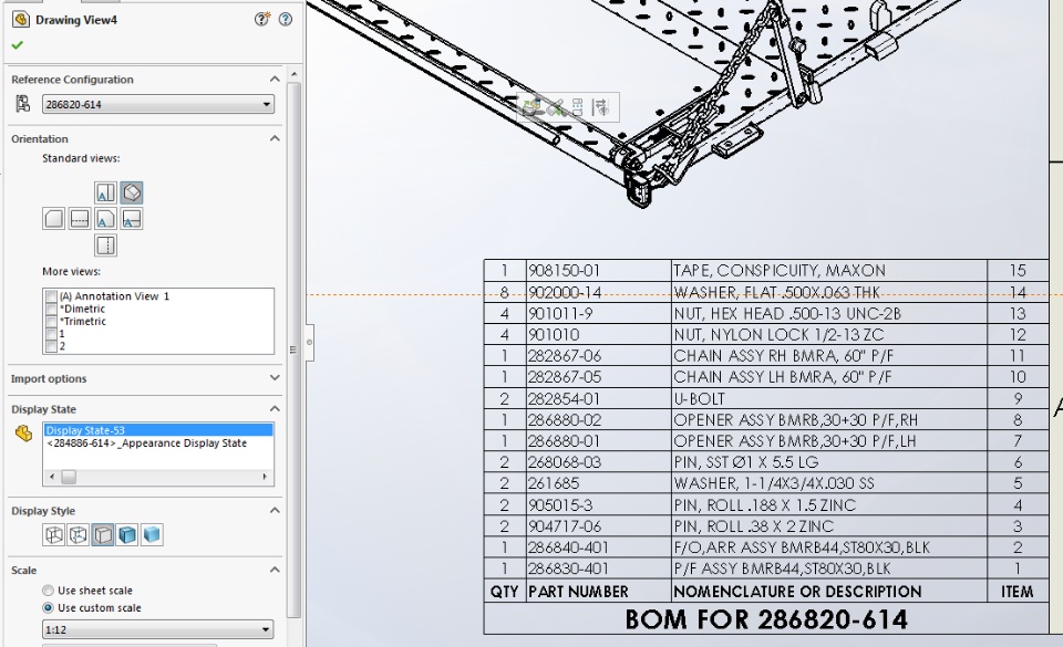

The Reference Configurations is used to get the configuration & fill in the Tilte
Configuration not matching to Reference View
I must be missing something or there might be a bug.
Thank You!!
