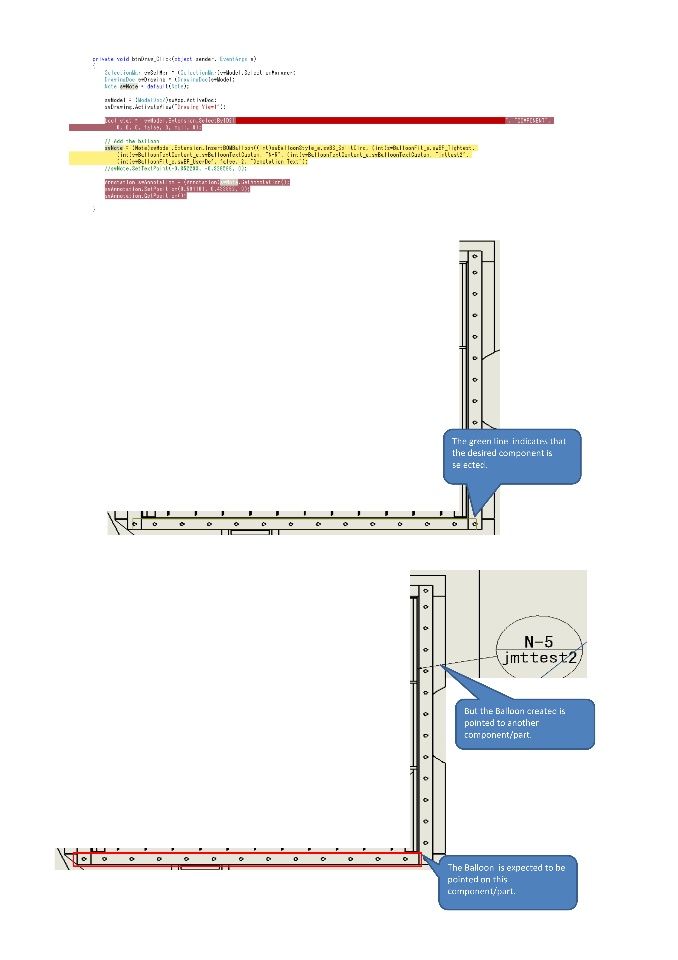

Has anyone encountered creating a SplitCricle balloon for Component1, the program selects the right component,
but when the InsertBOMBalloon is excuted, the arrow is pointed to different component, let's say Component2.
Please see the attached file for additional reference.
Thanks in advance.
