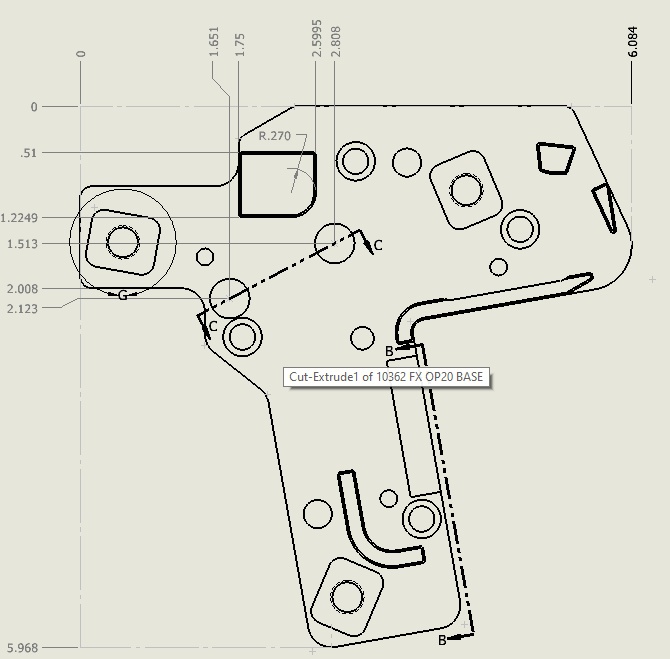

When I use sketch geometry in a detail view and continue the ordinate dimension from the parent view the dimensions to sketch geometry are incorrect while dimensions to model geometry are correct. What is also strange is when I click the sketch point the dimension is correct but after clicking again to drop the dimension it switches to the incorrect value. I know this used to work fine, am I doing something wrong here?

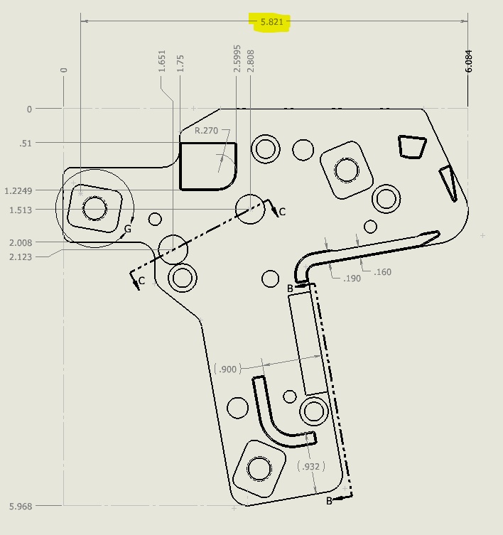

Update: The dimension is some how coming from the opposite side of the part, see last image.

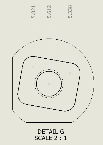

Dimension to model

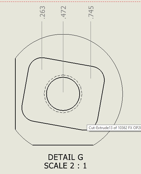

Dimension to sketch points
Parent view
Dimension seems to be referencing the opposite side of the part and not the ordinate zero
