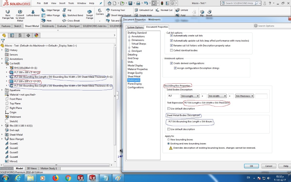

In SW-2018 how to link the sheet metal (SW-Length, SW-Width & SW-Thickness) to description property
Dear all,
In SW2018 please advise the possibility of linking the sheet metal (SW-Length , SW-Width & SW-Thickness) to the description property place to populate its values in the cut list as showing in the attached pic (look at the blue circles).
the boss-extrude plates description showing its values in the cut list (look at the red circles).
