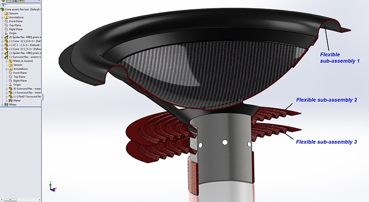

I have a model of a speaker. I would like to simulate its movement for a rendered animation. So far I have been able to make the parts flex the way I want within their own small assembly. When I put the flexible sub assemblies(set to flexible) into the larger assembly shown below, the flexible parts don't update.
Each flexable assembly consists of of three parts ... an outer flange, an inner flange and the in-context part between them.
Question:
Do the in-context parts need to be created inside the larger assembly in order to update or is there a way to have them update as sub-assemblies?
