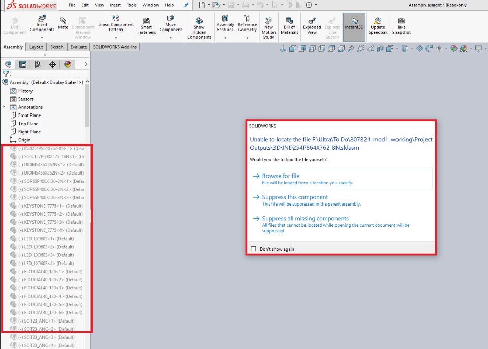

- Import stp file into soldworks
- This error appears on the screen:
- IND254P864X762-8N and all these other missing components are not present in the design I am trying to import.

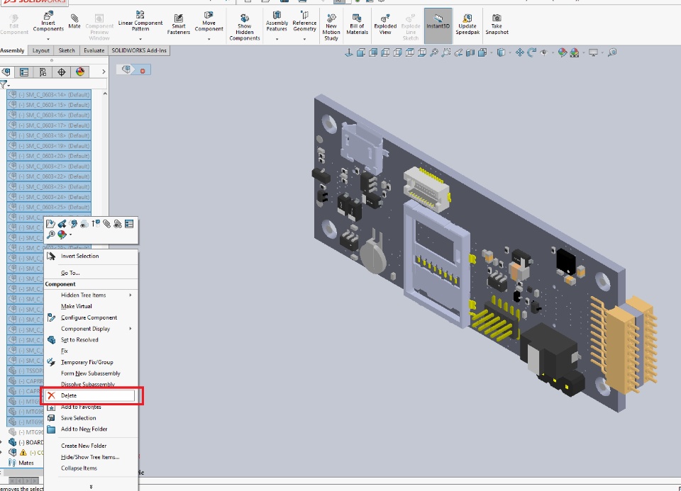

- Suppress all missing components
- Highlight and delete all the missing components

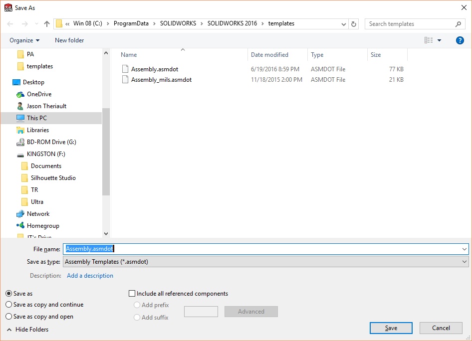

-Save the assembly
-Solidworks thinks it's a template....???

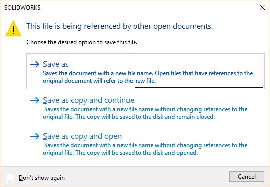

-I can save the design as a part with no errors
-When I try to save it as an assembly. I get an error for each and every component saying its referenced by other open documents...
