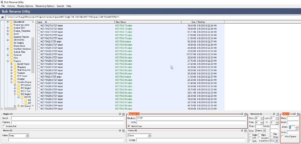

Check out this image: I think this is something that could be easily added to SW explorer.:
You can see in the image I am removing the ".STEP" and adding the dash at X position. The new file names are in green. I click the button and its done. If I change it here I spend the next hour relinking SW to all the new file names... another PITB that I don't want to do.
