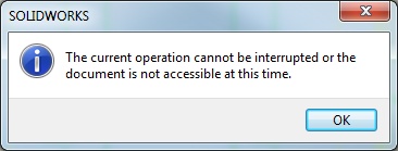

Here's the message SolidWorks gives me when I try to do anything in the drawing:
Thanks
