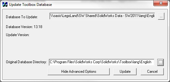

In my 2008 install, I created a special Menglish Hole Wizardstandard by copying the existing ansi metric standard and changingthe thru holes and counterbore sizes to english tool sizes.
Does anyone have a clue on how to get this into 2009? I am testing2009 at home and did not have this new standard in theSolidWorks/Data directory when I did my 2009 install. After thefact I placed a copy of the menglish standard into theSolidWorks/Data directory, but it doesn't show up in the HoleWizard standards.
My VAR is telling me I need to modify the install and then it willrebuild the toolbox and take care of it. I am going to try thistonight, but it seems that there should be some other way.
If I were a contractor and a customer gave me a HoleWizard/Toolbox standard to use, I should not have to modify myinstall to do this.SolidworksParts And Features
