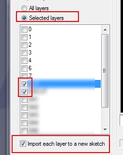

How can I select specific layers for import and how can I import each layer on a new sketch for import as shown in the dialog attached?
