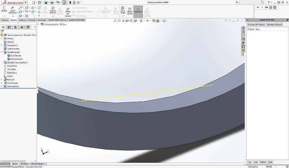

I'm trying to project curves onto surfaces without planar guarantees. I finally got the calls to work despite the anemic documentation that is IModeler and IBody2::Display3(), however, my lines stay straight instead of being warped to stick to the surface. Is this expected behavior or am I doing something wrong?

            Curve converted = trimmed.MakeBsplineCurve2();
            Curve projected = modeler.ProjectCurveOnSurface(converted, surface, vnorm);
            Body2 temp = projected.CreateWireBody();
            temp.Display3(model, Information.RGB(255, 255, 0), (int)swTempBodySelectOptions_e.swTempBodySelectOptionNone);
            // ^^ displays it, we're done ^^
