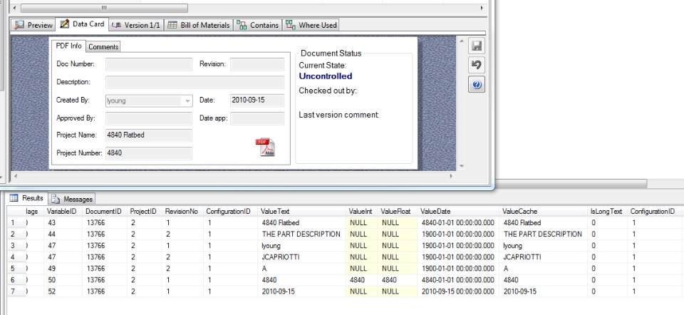

IEdmBatchUpdate2 or IEdmEnumeratorVariable8 not updating local client?
Has anyone come across an issue with IEdmBatchUpdate2 or IEdmEnumeratorVariable8 not updating the local client? I am seeing the changes in the database but the file card is not showing the updated variables. I have tried IEdmFile5.GetFileCopy(), IEdmFile5.Refresh(), and IEdmEnumeratorVariable8.GetUpdateVars() and nothing is working.
Is there anything anyone can think of that I am overlooking or can suggest?
