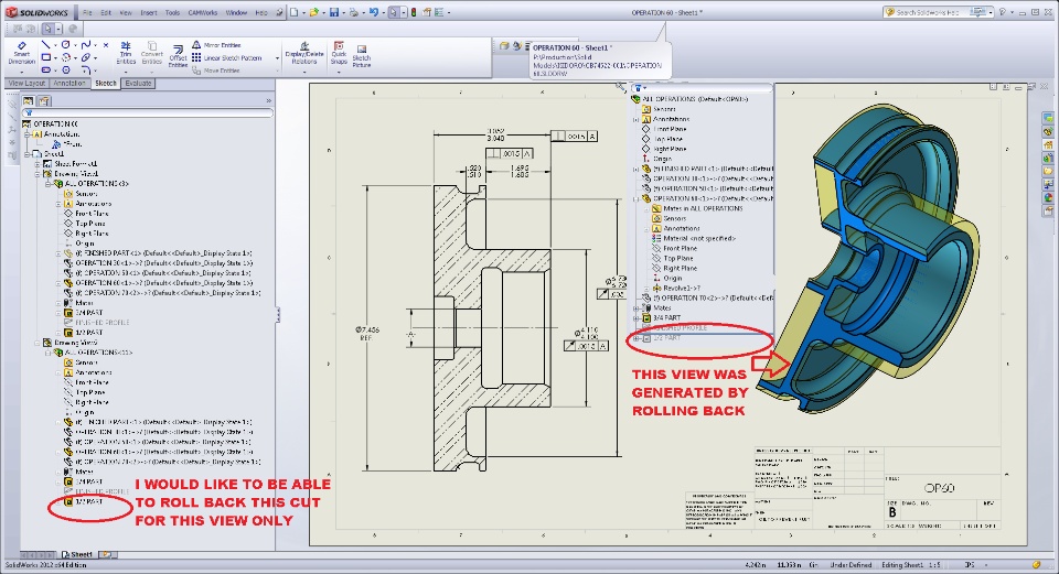

I would like to have 2 different assembly cuts in my drawing 1 for dimensions (1/2 part)
Hello all,
I've tried several things without success on this drawing for what I need. I would like to have 2 drawing views, one with 1/2 part for dimensioning & another drawing view with 3/4 part for ISO view. I would like to disable one "assembly cut" for one drawing view and have the other "assembly cut" on for the other drawing view. I edited screenshots in paint to be able to explain exactly what I need. The attached drawing included is what I want but haven't been able to do.
