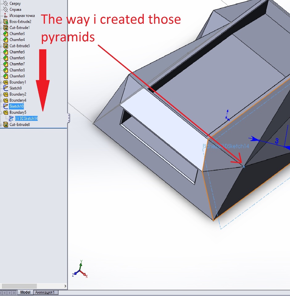

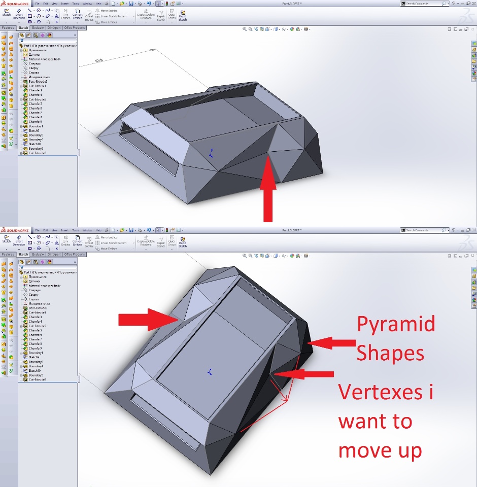

Hello, i need some help with my model! I am new to Solidworks. I am a Maya/3D max user and find modeling in Solid works a bit confusing and complicated. I have this model (on the picture) and i want to raise those 2 points/verticies between those pyramid shapes on my model. I dont want to have that "hole" pointing intside the model between them. Instead i have marked everything on the picture below! I marked the way i want my vertex to be located with red lines. Those pyramid shapes i made by drawing 2 sketches on 2 sides of the model ,then creating planes on 3D-Sketches parallel to those sides, then creating points where i want the highest point of those pyramids to be and then chosing my 4 side sketches and those points and applying Boundary Boss/Base! But i have no idea how to raise those vertexes between those pyramids... Thanks for help guys!Thanks for help!

gm John - First thing I noticed was in your 3D sketch there is a - sign ahead of the sketch - that tells us the sketch is under defined, in other words you need to lock in all your sketches with dimensions or equal lines etc... Depending on the sketch and how it relates you may only need one dimension to raise the vertexes up like you need them to move..

In your Sketch5 I added dimensions to the different points - Your sketches need to be black, no blue lines - Blue Lines = under defined
In all your 3D sketches you need to add additional dimensions, what I did is added lines from the end points of Sketch5 lines to the point in th 3DSketch1 and then added dimensions.  You don't really need lines - you could also just apply dimensions where the lines are.
You can change your dimensions to move the point

Try this - Edit your 3D sketches and move the point.

But i want to raise the point that is right between those 2 pyramids, at the lowest position. Not highest points of those pyramids.

Then edit the sketches that control that point and move it up - the one is Sketch5

I created some dimensions using smart dimension tool. But the problem is that i am only able to edit them along 2 axis along that face. I want to move the point up in the 3rd dimension..

Yes - thats what im trying to do right now. But how do i set up a dimension to be pointed perpendicular to the face? And not along it?
