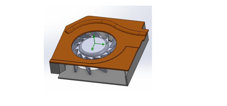

I need for help for simulation a centrifuge fan

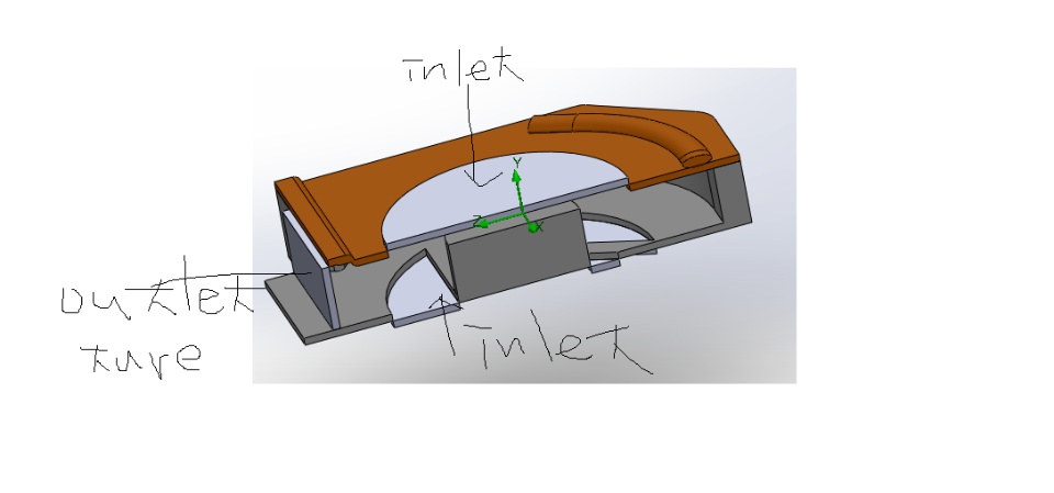

       At first ,this is my model

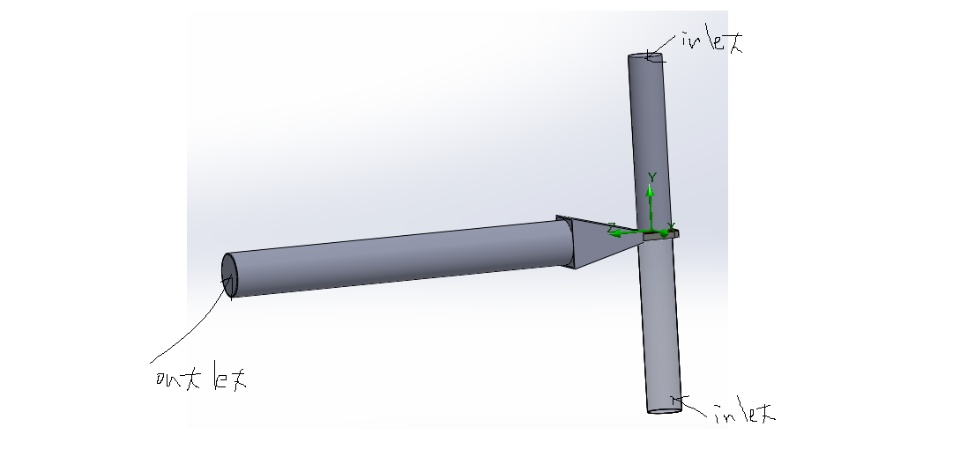

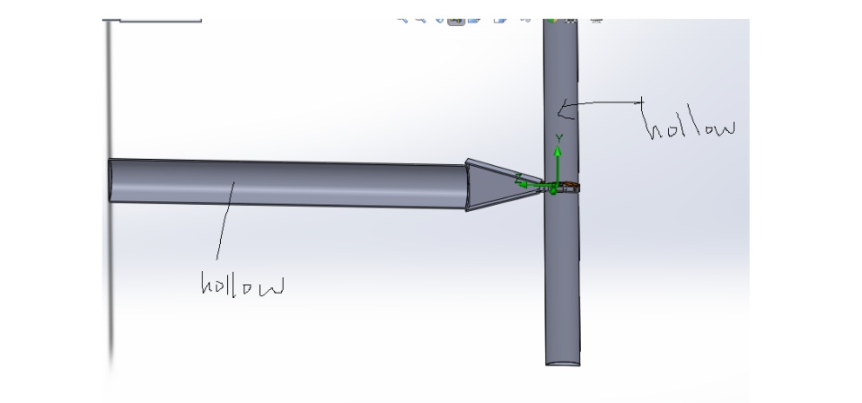

     And this is my domain (for AMCA 2100-99 text)

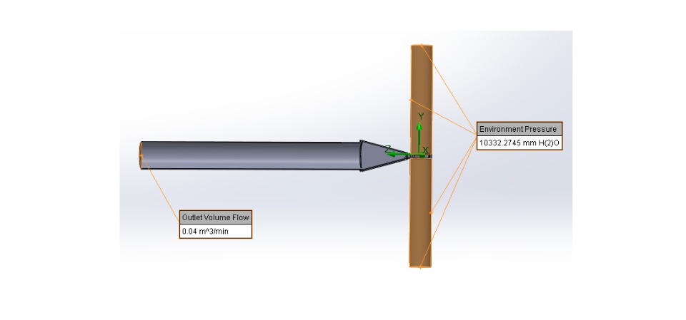

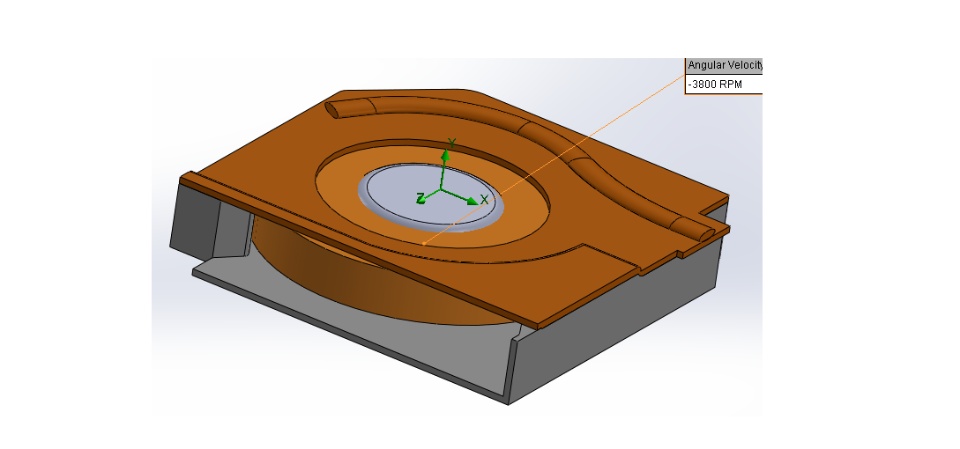

And this is my seting ,i want to find the P-Q curve
B.C                                                                                                                                                rotational zone

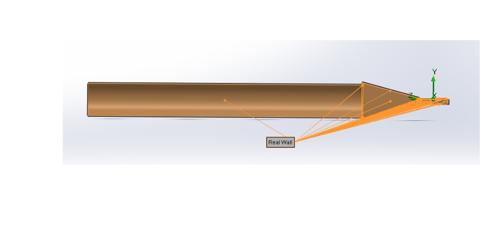

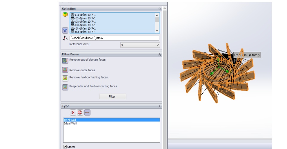

fan (stator),you can see ,i choose the fan,and set the filiter Faces
choose "Romove out of domain faces","Romove outer face" ,"Keep outer and fulid-contacting faces">>Reall wall (stator)
you can see the fiuge
And then
choose "Romove out of domain faces","Romove outer face" ,"Keep outer and fulid-contacting faces">>Reall wall (no stator)

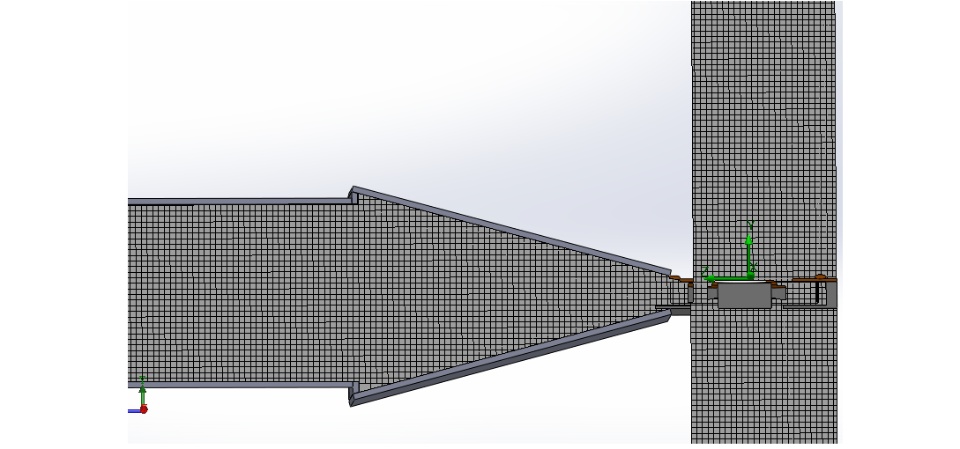

And this is my Mesh

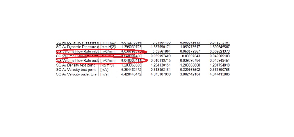

And this is my Result
There is a big problems,
SG Volume Flow Rate inler is -0.0397cmm
SG Volume Flow Rate outlet ture is 0.040cmm
I know the positive and negative is represent the direction,I check all of the teach video,the negative is represent the flow is out......
So my result, it maybe wrong........

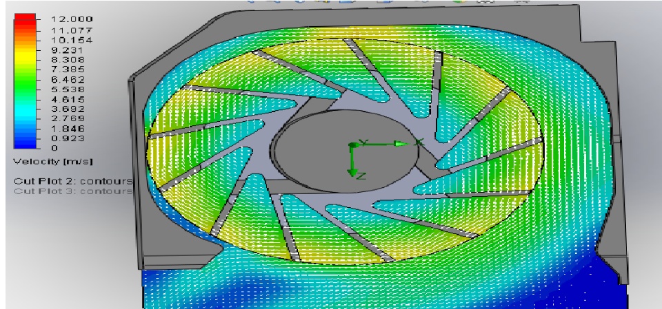

But I see the Cut plots
the velocity is out of the outlet ture.......
Could you tell me why?And it's wrong,or somthing unreasonable, please tell me why.......
I have experiment for text this fan,the simulation's result it have a lot of Error for ture ,could you give me some suggest?   Thanks....
