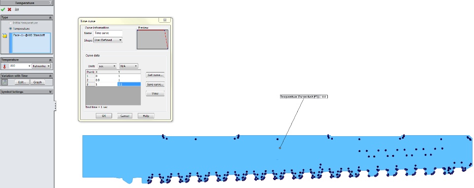

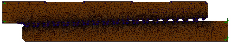

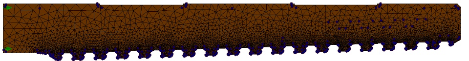

I am analyzing a coupling/pipe connection for the oil and gas industry.  It's basically an API connection.  I'm doing an axisymmetrically simplified, nonlinear static study.  The threads are mated by load flank and there is some interference built into the study.  I am gradually applying contacts to each thread, but have chosen to move one at a time for now so I can catch any problems immediately as they arise.  After applying the shrink-to-fit contact to the innermost thread (left-most) of the coupling and the pin's corresponding "trough" or root, I ran the study and everything worked fine.  I then proceeded to do the same with the next thread; this is when I was prompted with my error that the incremental strain is too high (along with two other suggestions).  To remedy this, I have attempted to apply a thermal load to allow the coupling to move from an expanded state to a contracted (back to initial) state in which the interference would be built up.
I excluded the other component from the analysis so I could see the effects of the thermal load.  I applied my thermal load so the temperature would begin higher than the one I specified as its "temperature of zero strain" and would then decrease to the zero strain temperature.  I also added a moving fixture to the left side of the coupling to move with the thermal contraction so as not to allow stress buildup, although I made it stationary to simplify things.  I then ran the study (again, with the other part excluded from the analysis).

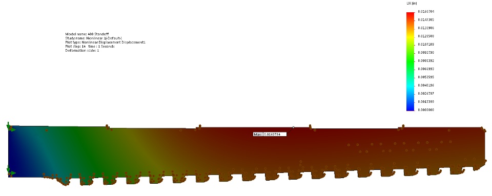

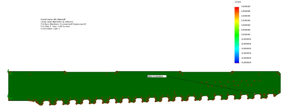

The study gave results that the coupling was contracting, but that it was doing so from the zero strain position, thereby ending in strain at a more contracted size.  I have been tampering with this for a while, but I cannot get it to do what I need for it to do.  Is there something I am doing wrong?

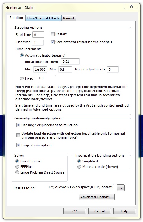

first impression is that you're picking and clicking rather than really putting together a strategy for solving this problem. for example you've chosen the large strain mode, remember this only applies to certain material models.

I had originally not chosen "large strain mode", but when only working with the first contact set I described, convergence didn't happen until after I had checked it off.

Are the pictures not available to you?  I would think they are more than sufficient, along with the rather lengthy verbage I provided, to convey what I'm doing with the thermal load.  Please let me know if you can't see the pictures.
If you can, then look at the ones titled "TempTimeCurve.PNG" and "ZeroStrainTemp.PNG" so you can see exactly what I've done.  I instruct the coupling to begin at 10 times the zero-strain temperature so it will begin in an expanded state.  Then, at 0.9 seconds pseudo-time, I have the temperature return to zero-strain temperature so the coupling will contract from said expanded state.  Again, the problem is that the coupling never starts from the expanded state, but from the zero-strain state, from which it contracts to a contracted state of smaller than the pitch diameter of interest (I included the before and after pictures of the results as well).
