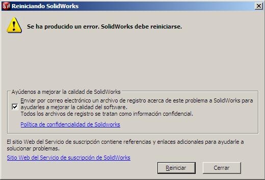

Step 4 - Then close the part. Now is when SolidWorks aborted.
When i close the part, I get the following message.
I think the problem is in the events, but I can not say because I can not see where it failed.
