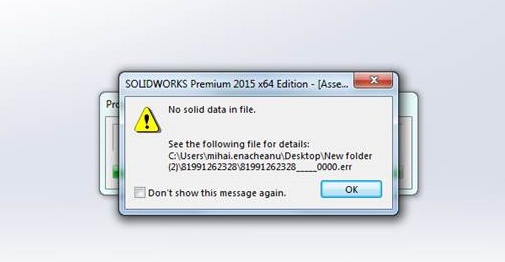

I tried to open it and got the error attached file: "No solid data in file". I opened the .step file (the structure file) with notepad and I did find the names of the .stp along with their coordinates.
If i try to import each .spt file it works but if I try building the assembly i have no information for mating them.
Do you have any ideas how can I open it?
I have SW 2015 Premium SP0, but I tried it with SW 2015 SP4m and got the same result.
