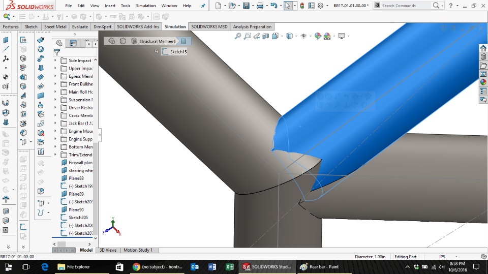

I am working on creating a FSAE frame using structural members and my trim command is not trimming a small part which I believe is why my mesh is not working properly. Has anyone had this issue, I have tried allowing the extension and not with the same r
As can be seen below, the trim is cutting through the other member.  I believe this is one of my issues when it comes to meshing the model.  Am I doing something wrong? Is this a small issue that shouldnt matter?  I have tried everything I knew and would love some tips to get rid of this issue. Thank you!
