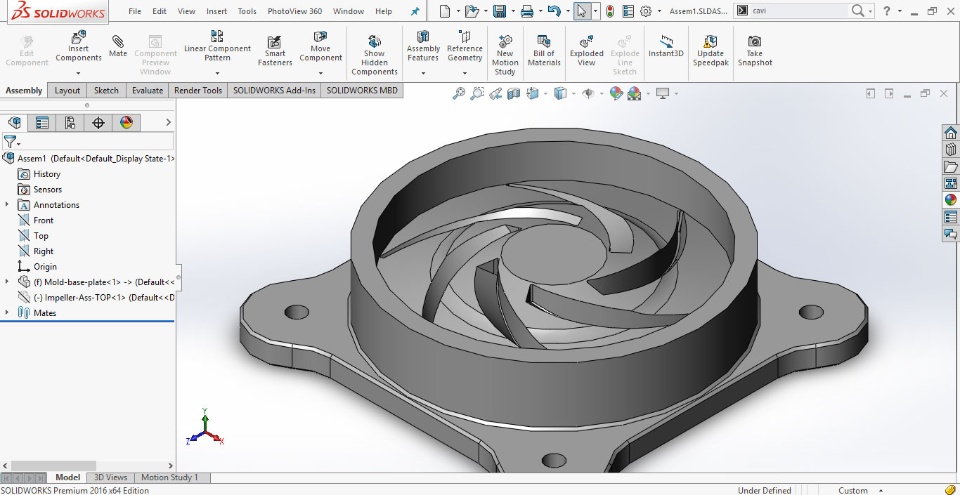

I am trying to make a mold/fixture for my part to fit into when they both are 3D printed. but i can only make exact fitting between the two parts when i use the command "Cavity" to make the mold. But i need the part shaped "hole" in the mold to be 2 mm larger than the part which needs to fit into the mold. Can i do it in solidworks and how???

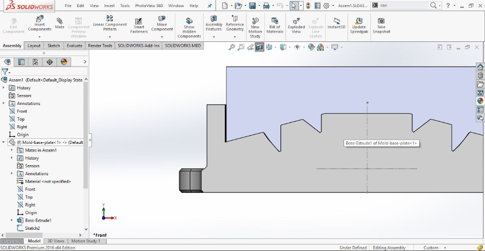

The problem by using simple scaling in "Cavity" is that it offsets everything instead of "growing" every surface a little bit bigger:
Hope someone can help, because 3D printing makes every thing a little bigger and every hole a little smaller, so i need to compensate for the differents in sizes.
