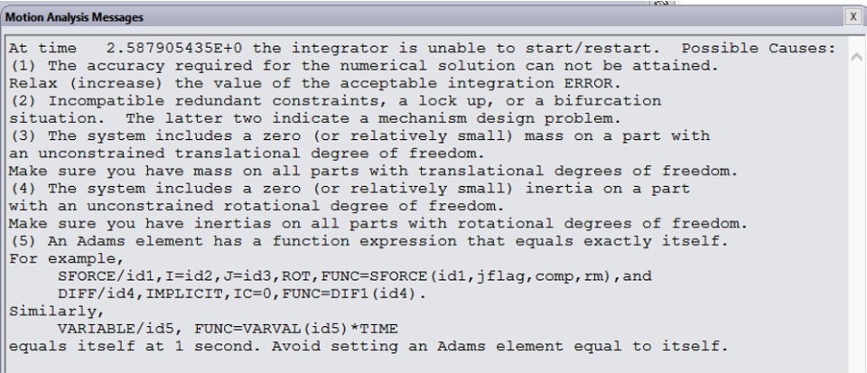

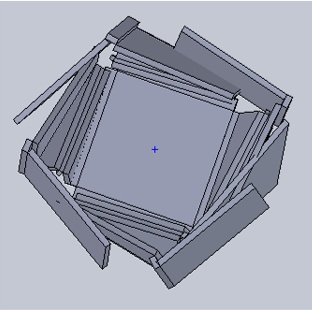

I am getting this error while running a motion analysis for 3D 4-sided flasher. Can someone please explain this error?
