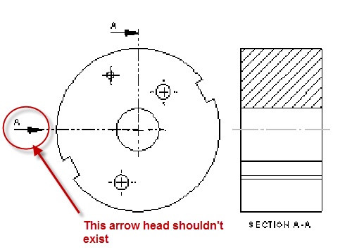

Oh finally, the section views section properly!  And it's sooooo much easier to create section views!  I love it!  I haven't tried everything yet, but I like almost everything I have tried so far.  My only concern so far is with the arrow head display of a half section. The trailing arrow head that is inline with one of the cutting plane lines shouldn't exist (see image below).  I couldn't find any good examples in the ASME specs that showed one way or another, but from what I remember in my drafting classes, that arrow was omitted.
