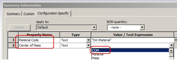

How would I link part properties in a drawing
I have a drawing fully detailed and I want to make a note that has the material code and the center x,y,z coordinates for the center of mass. So, when the part changes so do the notes.

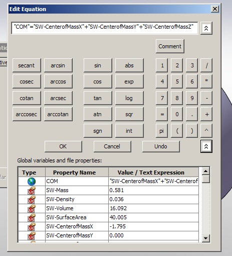

I know how to use "LINK TO PROPERTY" for common stuff like the document name, and part name, but the material code and the center of mass is not located in the list. Do I have to manually type in the code to find the "PROPERTY" that I am looking for?
Also, Is there a way to Put this link in a template drawing so every time you put a part in the drawing, the mass and center of mass are already updated?
