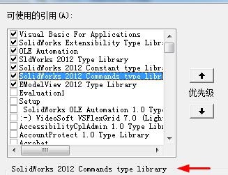

for example
Quote Solidworks 2012 type library
VBA connect Solidworks Code.
  Dim SwApp As SldWorks.SldWorks,
    Set SwApp = GetObject(, "SldWorks.Application")
Help me

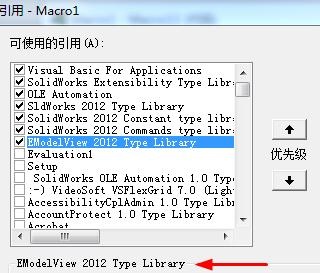

Quote EModelView 2012 Type Library
   Help me, How to use the VBA connection, edrawing
Follow code , don't open SaddleS.Easm file.
Private Sub llll()
  Dim e As New EModelViewControl, FileName
  FileName = "E:\\MyWorkSummary\\BESmodel\\卧式储罐\\Tank2008\\SaddleS.Easm"
  e.OpenDoc FileName, False, False, False, ""
End Sub
