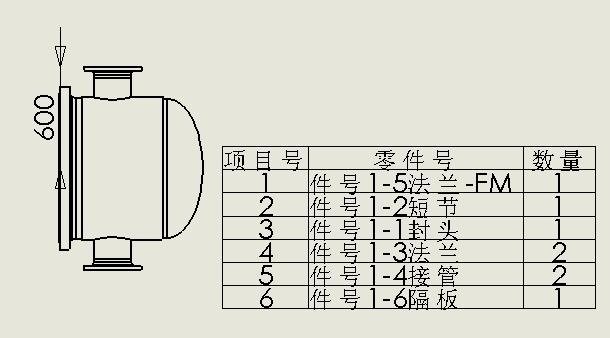

How to use GetBomTable?
use key  code: Set swBomTable = swView.InsertBomTable2, Success, see follow Code.
but use key code  Set swBomTable = swView.GetBomTable()---- don't success.
Target:
debug.print Result
项目号,零件号,数量
1,件号1-5法兰-FM,1
2,件号1-2短节,1
3,件号1-1封头,1
4,件号1-3法兰,2
5,件号1-4接管,2
6,件号1-6隔板,1
see Fig
