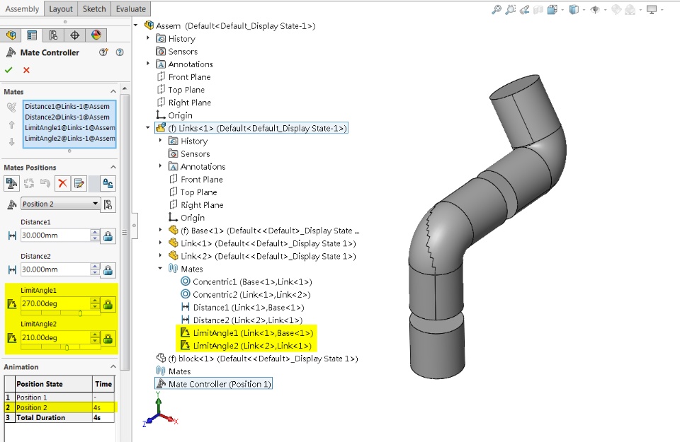

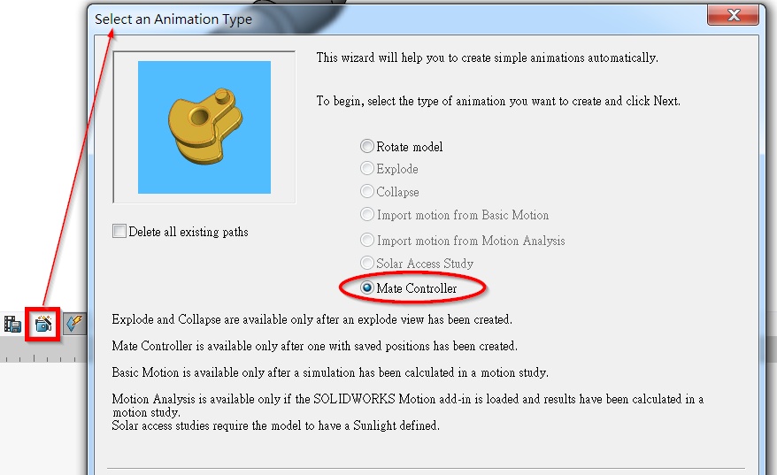

In SW2017, I want to use API to make an animation in a motion study by animation wizard which can import the mate controller setting.
Using Record Macro ,unfortunately, I can't find the key codes about mate controller api and codes about how to import mate controller setting into a motion study.
There are only codes about selection functions.
[Macro : Mate Controller Setting ]

[Fig1. Mate Controller Setting]
[Fig2. Animation Wizard Setting]

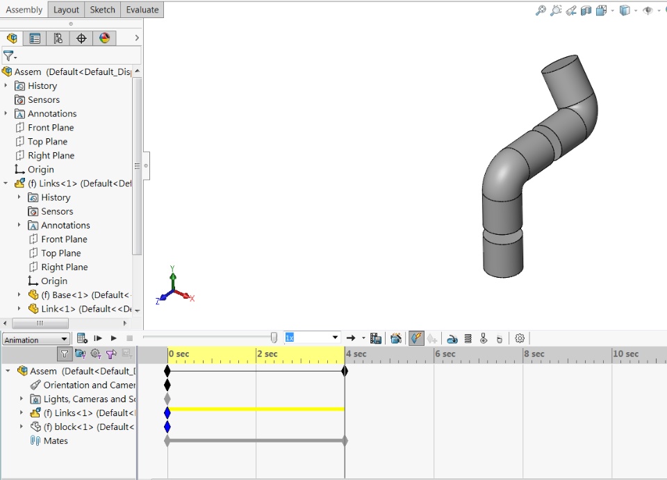

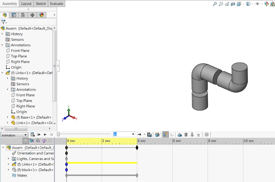

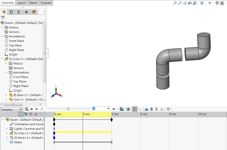

[Fig3. Animation in Motion Study]
