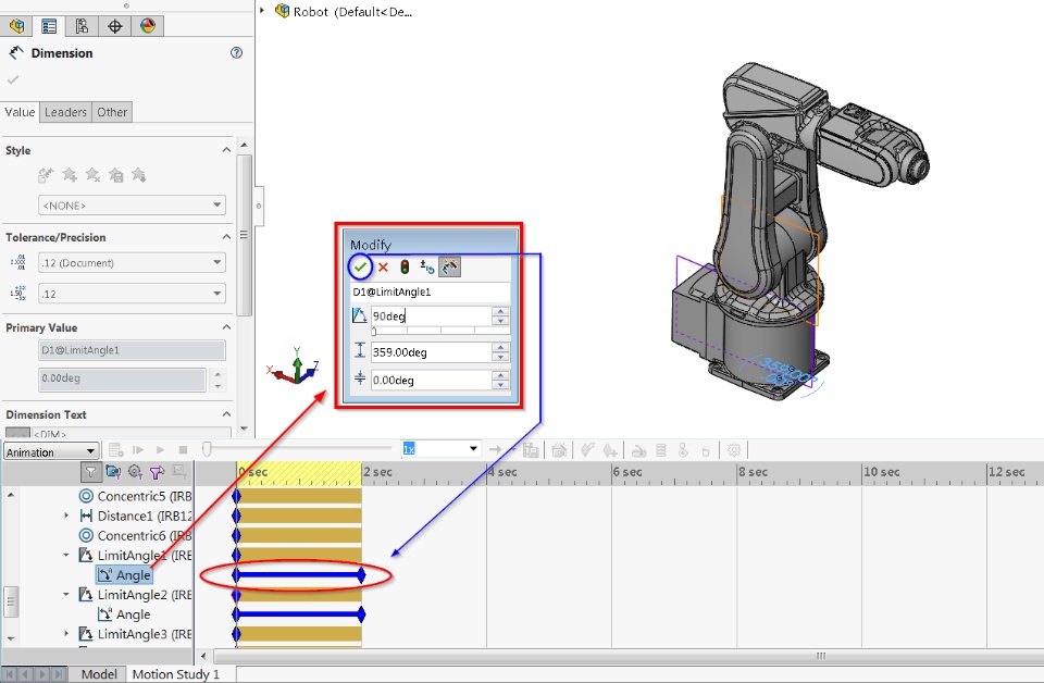

How to use API to edit dimension value of the mate in motion study?
In manual method,I can edit dimension value of mate in motion study.
I also record the macro when editing.
But when I run the macro, it can't present the same results as in the manual method.
In the macro, it can't edit dimension value of mate in motion study.
What's wrong with the code?
There are complete files in the attached file.

Set Part = swApp.ActiveDoc
Dim motionStudyMgr As Object
Set motionStudyMgr = Part.Extension.GetMotionStudyManager()
boolstatus = motionStudyMgr.ActivateMotionStudy("Motion Study 1")
Dim myMotionStudy As Object
Set myMotionStudy = motionStudyMgr.GetMotionStudy("Motion Study 1")
boolstatus = myMotionStudy.SetTime(2)
boolstatus = Part.Extension.SelectByID2("LimitAngle1", "MATE", 0, 0, 0, False, 0, Nothing, 0)
Dim myDimension As Object
Set myDimension = Part.Parameter("D1@LimitAngle1")
myDimension.SystemValue = 1.570796326795
boolstatus = Part.Extension.SelectByID2("LimitAngle2", "MATE", 0, 0, 0, False, 0, Nothing, 0)
Set myDimension = Part.Parameter("D1@LimitAngle2")
myDimension.SystemValue = 0.7853981633975
