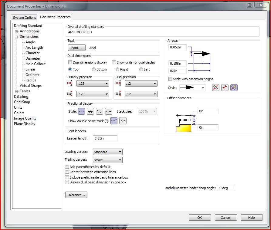

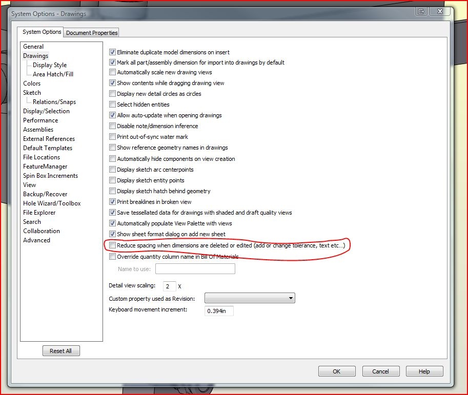

I know this is because of the new "rapid dimension" function but I swear I read there was a place to turn off the dimensions adjusting automatically. What I remember reading was to set the dimension offset distance to 500 and uncheck some box under document properties-dimensions that would prevent the dims for adjusting. I cant seem to find this box. Am I dreaming?
I like what the rapid dimension function does but it just doesnt work for me. I am required to place all my dimension text horizontally and having only one dimension offset setting really kills this function. Am I missing something?
