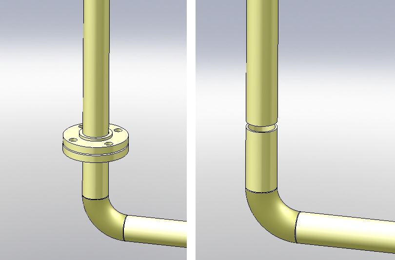

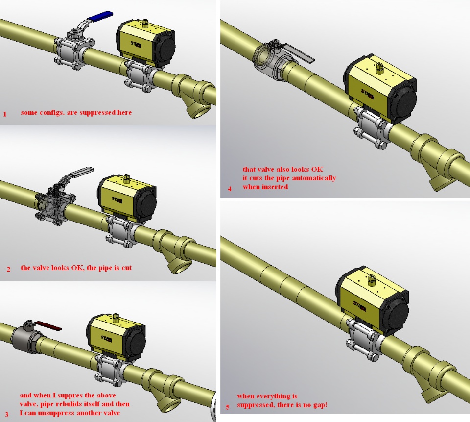

Hi,
I am working on a routing assembly and I need to create different configurations for pipe routes.
Some of the pipes have flanges, some of them have valves and some of them have nothing on them.
When I add any component on a pipe, lets say a flange (shown in the picture)
and then when I want to suppress that flange on another configuration,
I end up having a gap between the pipes, which SolidWorks automatically creates while adding the flanges.
How do I workaround this, is there a way to end up with a whole pipe, after suppressing the component?
Thank you.
