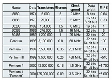

The simple days of computing: Sizing a computers CPU's was based on only one CPU's Hz, the amount of transistors and the L cache sizes of that CPU. All software written back in the 90's were centered on single thread processing (time-division multiplexing). ## see images attached
Now a single box computer is in reality multiple computers in one simply by the new technology of multi-threading (kernel threading) CPU technology.

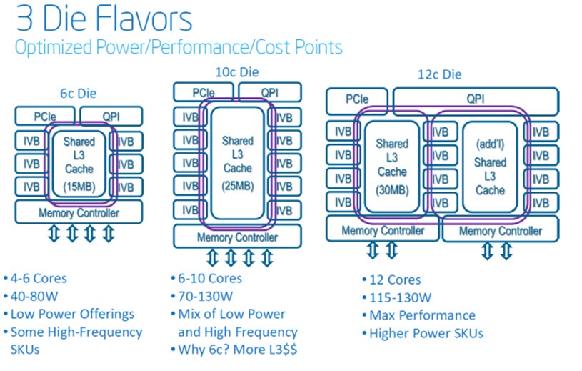

Welcome to the Xeon E5 Lvy Bridge EP.
Single 6c Die socket: 6 CPU's (a core is a CPU), 24 logical CPU's (a logical CPU is a software image of a core times 4), One L3 15M cache, one front side bus controller. Note: 3+ GHz for each CPU, bus speed based on 15M cache. Multitasking shared by 24 logical CPU's with a 15M L buffer.* Size according to I/O speed of your outputs.** The horsepower of the software. ***
Single 10c Die socket: 10 CPU's (a core is a CPU), 40 logical CPU's (a logical CPU is a software image of a core times 4), One L3 25M cache, one front side bus controller. Note: 3+ GHz each CPU, bus speed increased by 25M cache. Note: 3.5 GHz for each CPU, bus speed based on 25M cache.  Multitasking shared by 40 logical CPU's with a 25M L buffer.* Size according to I/O speed of your outputs.** The horsepower of the software. ***
Single 12c Die socket: 12 core (a core is a CPU), 48 logical CPU's (a logical CPU is a software image of a core times 4), Two L3 30M cache, two front side bus controllers. Note: 3+ GHz for each CPU, bus speed based on 30M cache. Multitasking shared by 48 logical CPU's with two 30M L buffer.* Size according to I/O speed of your outputs.** The horsepower of the software. ***

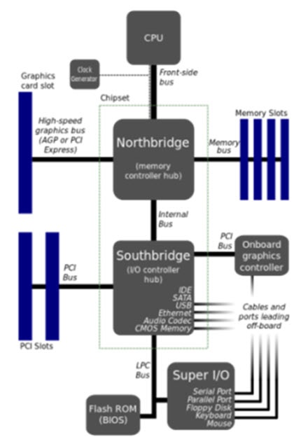

**Size by bus Speed: I/O chipset bus speed (motherboard), hard drive access and bus speed (interface, SATA, SAS, RPM, buffer), physical memory RAM (DDR3) bus speed, Ethernet Mbps speed, video controller buffer size and speed High priced, fast CPUs will only bottleneck on the backend thus wasting the high front end cost. Example: oversized expensive CPU's processors, process arrays in microseconds then have to sit and wait for the slow Southbridge, (hard drive to deliver the data through the LAN then to the monitor).

The Xeon E5-2600 V2 or "Ivy Bridge EP" (Hashwell Achitecture)
The core architecture inside the latest high-end model of the Xeon E5-2600 V2 or "Ivy Bridge EP" is, aside from the core architecture, completely different from the Ivy-bridge "i7 \\-3xxx". With up to twelve cores, two integrated memory controllers, no GPU and 30MB L3 cache, it is the big brother of the recently reviewed Ivy-bridge E (Core i7-4960X). Intel has three die flavors of the Ivy-bridge EP:
The first lowest core count (4/6 cores), (high frequencies) or low power SKUs; this is the core being used in the enthusiast Ivy Bridge-E processors. The second one is targeted at the typical server environment with higher core counts (6 to 10 cores) and a larger L3 cache (25MB). The third and last one is the high performance HPC and server die, with 12 cores, two memory controllers for lower memory latency, and 30MB of L3 cache.

  1. 1. There are two physical buses on x86-processors address+data and two logical buses memory+i/o. Special pins on the processor determine if the operation is memory or i/o, read or write and so on. On the 8086/8088 the data and address buses shared the same pins A0-A15 with D0-D15/A0-A7 with D0-D7 with bits A16-A19/A8-A19 being strictly address. On the 80286 they were separate, not sure about the 80186/80188. On the 80286 there were 24 address and 16 data lines. On the 80386 and 80486 there were 32 each for address and data. The 80386SX had the same external configuration as the 80286. After this buses get complicated. The processors run so fast internally that they are more or less constantly waiting for their caches which in turn are more or less constantly waiting on external RAM. To satisfy the caches' insatiable hunger for data external memory began delivering it in 64 bit wide chunks starting with the Pentium and Pentium MMX that are both 32 bit processors with 32 address lines but with 64 data lines. With later processors the number of address lines were increased to 36 allowing a total addressable external memory of 64 GB. The processors remained 32-bit internally. On multi-core processors the hunger for data is even more pronounced so they may have several sets of address and data buses to facilitate data being crammed into the processor. Desktop processors may have two or three and server processors three to four. Some may have switched to 128 bit wide data buses. For modern 64-bit processors it is not feasible to also have 64 address lines since that would allow memory up to 16 billion Gigabytes which is not possible today. Some motherboards allow 128 GB which means that the processor needs at least 37 address lines. As you can see address and data buses are no longer really usable to determine processor size. They actually haven't for the last 25 (80386 modes) years. In C the int type is supposed to be equivalent to the register width. On AMD64 it isn't because there just isn't that great a need for 64 bit ints: 32 bit ints do just nicely in most cases. The width of a pointer in C on AMD64 is 64 bits though.

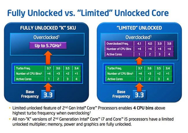

   5. i7-2600k: unlocked; i7-2600: locked, the "2600" is just a model number.
The k means the processor has an unlocked multiplier, meaning you can overclock the CPU in the bios by simply increasing the CPU multiplier.
When a single core is active, the chip can turbo up to 3.7GHz. If you want, you can change that turbo state to go as high as 4.1GHz. Overclocking these chips relies entirely on turbo however. In the case above, the fastest your chip will run is 4.1GHz but with only one core active. If you have four cores active the fastest your chip can run is 3.8GHz
the Core i5-2500K and Core i7-2600K are fully unlocked and will let you overclock them as far as the CPU and/or your cooling can sustain.
