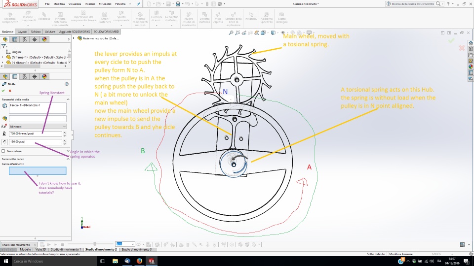

I'm trying to simulate a clock escapment on solidworks 2016. Unfortunately I'm not able to find a solution on my own and I checked in many tutorials the way to resolve it, but with no results.
I hve to set a torsional spring who is without load in N point and turns about 270° in compression in one way and 270° in extension in the other way.
I attach an image to explain. The setting are differents because I have done few trials to reach a results but is not working as in the real world works.
what I want to find with solidworks are:
-the konstant of the spring ( need for dimensioning the spring);
-the frequency of the pulley and relative spring;
-the time for every cicle.
I'm really near to this results in matematichal calculations, but i want to find them in solidworks.
So if I'm following a wrong system to do that can you suggest me a better way to reach the result?
