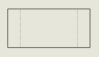

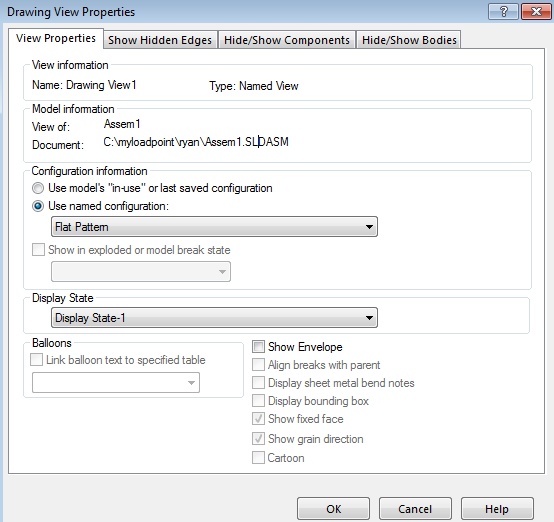

  7. Create the drawing, bring in the top view and select the flat pattern configuration.
  8. Navigate down the FeatureManagerDesign Tree and locate the bend lines feature in the flat pattern of the part and show
Does anyone have any ideas on how to generate the bend note information? Please let me know if this is even possible. Thank you.
