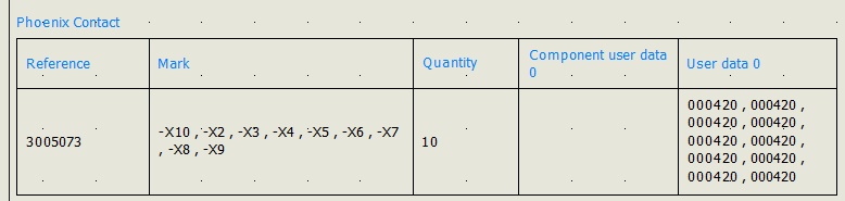

I've got an ERP connection set up to our PDM database, and I'd like to show our own part number in a BOM table.
It's mapped to User Data 0 on the manufacturer part and appears correctly in the ERP data tab in the manufacturer part properties.
I've created a bom table, and when I choose columns:
- if I choose "Component User Data 0" nothing appears in the column
- If I choose "User Data 0" the data gets repeated as many times as the quantity.
How can I get the ERP field listed once in a BOM column?
