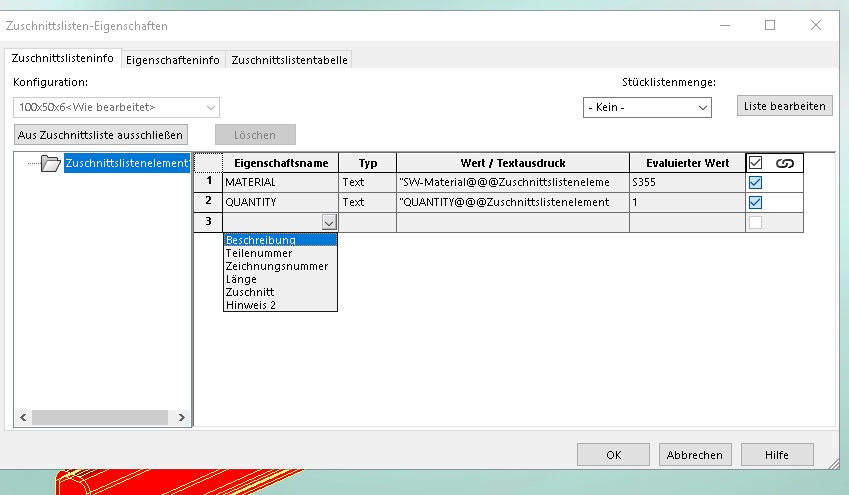

Hello,
the macro that I want to write takes a value out of a property from the Fileproperties and writes the value into the cutting list attribute.
The property is Teilenummer, the value of this property is taken into the code.
The attribute in the cutting list is also Teilenummer (it does already exist, see screenshot), and there I want to write the value.
The code makes a welded part and then updates the cutting list folder.
And then swFeat.CustomPropertyManager.Set2 is not working ?!
Screenshot of cutting list:

x2 = swFeat.CustomPropertyManager.Set2("Teilenummer", 222)
Dim CustomPropertiesAuslesen1 As String
CustomPropertiesAuslesen1 = "Anfangs"
Debug.Print "CustomPropertiesAuslesen1 " & CustomPropertiesAuslesen1
CustomPropertiesAuslesen1 = swFeat.CustomPropertyManager.IGetNames(9)
Debug.Print "x2 Nachher: : " & x2
' 1 = Custom property does not exist
'http://help.solidworks.com/2020/english/api/swconst/SOLIDWORKS.Interop.swconst~SOLIDWORKS.Interop.swconst.swCustomInfoSetResult_e.html
