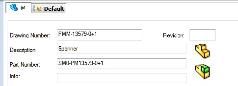

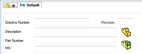

When I bring it into the vault I get two tabs on the data card, one as an "@" and one as a "Default".
My issue is that for our parts, I have "Part Number" and "Drawing Number" set as Manditiory Variables, and in the case above the part does not have these entered in the Default configuration as they are not needed.
"@" tab
"Default" tab

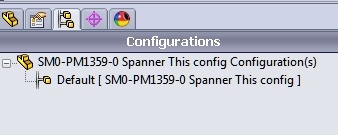

Configurations

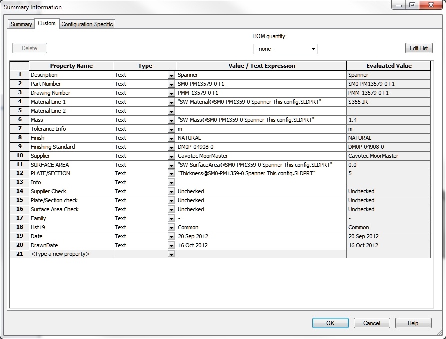

File Properties - Custom - set via Properties Tab

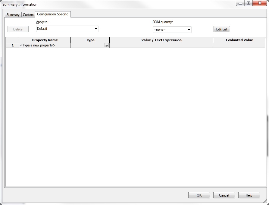

File Properties - Configuration Specific
