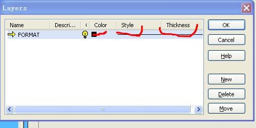

Target
How to set layer's style and color and thickness?
Thanks
