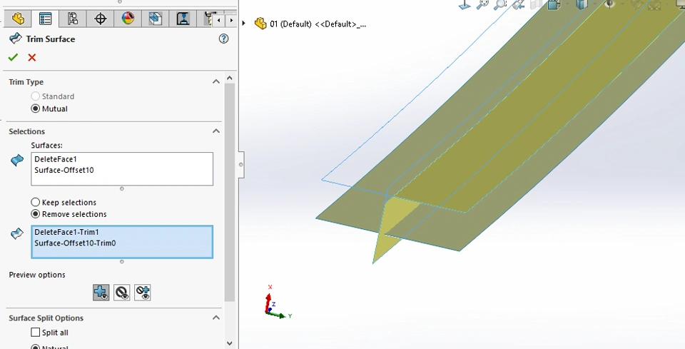

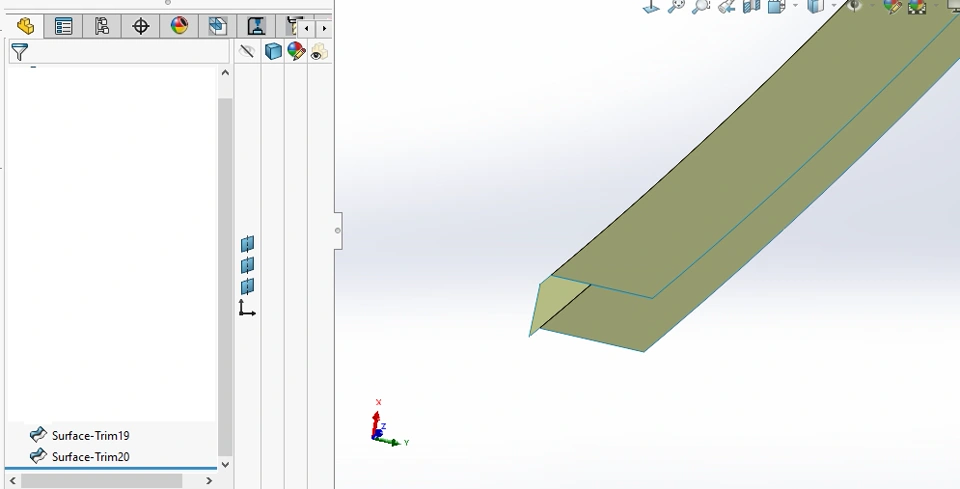

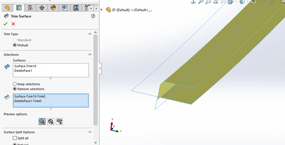

How to select surface without coordinates position
Hi, I am working on C# script for API.
I have created all feature on origin. I want to select surface without using coordinate position for trimming purpose.
My question:
Suppose, I have two profile surface too far from origin position and now I want to select this two surface for trimmingAPI Macros#Surfacing
I have attached cad model 2025 version
