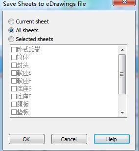

Help me, While Save eDrawings File, don't dialogbox.with API?
In the dialog box, select one of the following:
Current sheet.
All sheets.
Selected sheets. Select from the list below.
Dim sFileName As String, nErrors As Long, nWarnings As Long
    SwApp.SetUserPreferenceIntegerValue swEdrawingsSaveAsSelectionOption, swEdrawingSaveAll
    SwModel.SaveAs4 sFileName, swSaveAsCurrentVersion, swSaveAsOptions_Silent, nErrors, nWarnings
