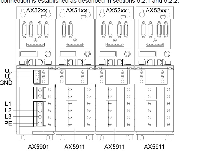

I've trying to figure out the best way to represent connecting Motor Drives via add on bridge modules. For every drive a separate bridge module is required, thus two symbols are needed for keeping track of components.
Below is a picture of what it would look like once assembled:

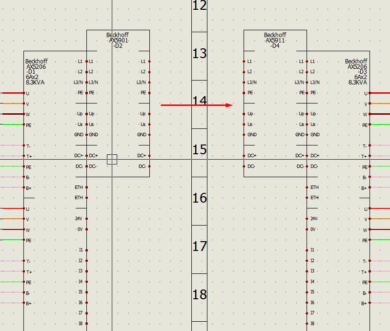

And up to this point this is what I have:
There would be wires coming into the left AX5901 since it is the first one and there would need to be a connection between the right AX5911 and the next AX5911 on the next page. And lastly a connection where the red arrow is.
I could always just uses wires to show the connection, and add a note, but I don't like it.
Thanks !
