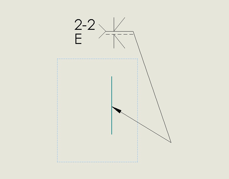

Hi,
there is one problem. I have weld symbol on drawing and it has jog point. I want to remove it, but cant.
My code:
swModel = swApp.ActiveDoc;
swDrawing = (DrawingDoc)swModel;
swView = swDrawing.GetFirstView();
swView = swView.GetNextView();
WeldSymbol sWeld = swView.GetFirstWeldSymbol();
1. I have also tried:
swAnn = sWeld.GetAnnotation();
swAnn.SetLeader3(0, 0, false, false, false, false);
This code hide leaders if they are not bent. In this case they stay visible.
2. I check for points coordinates
int lc = swAnn.GetLeaderCount();   // lc=1
int ls = swAnn.GetLeaderStyle();    // ls =2 - this mean that SW know that it bended
bool attached = sWeld.IsAttached();    //true;
bool extra = sWeld.HasExtraLeader();  // false;
All that mean that Leader has no extra lines and it bended and I must to take double array where it count more than 3
but i take
object[] AnnObj = swAnn.GetLeaderPointsAtIndex(0);   // NULL   !!!!!
or
double[] WeldDouble = sWeld.GetLeaderAtIndex(0);    // ZERO count !!!!!
So I even cant to take coordinates of jog point to remove after.
How to do that in easiest way.
Please help!
