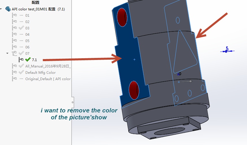

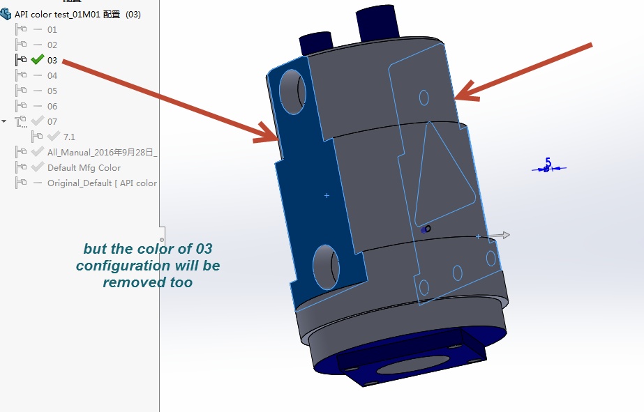

    I write a code to remove color on the face of the active configuration,but  when i run the code ,the color on the face of other configuration will be removed,can you help me ?(   i have set swModelExt.LinkedDisplayState = True)
