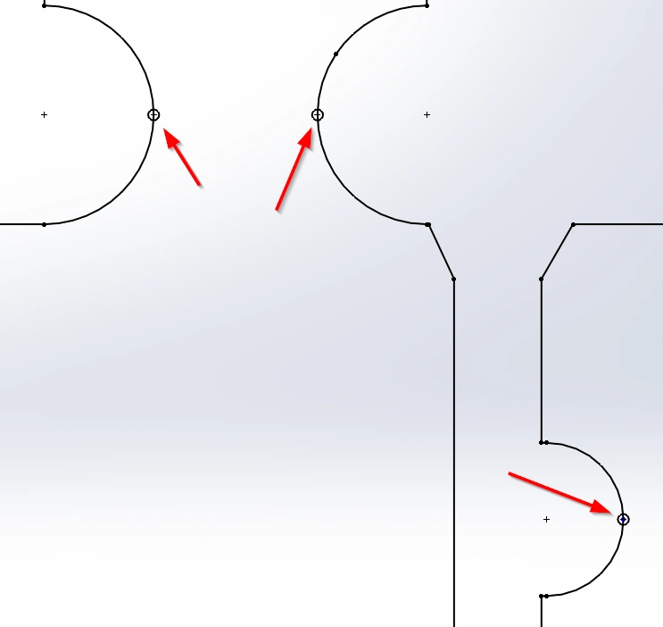

Is there any possibility to remove all circles from the Sketch in one step?
If not, is it possible somehow to write a macro or script to do that?
After importing of .dxf from EDA software I have each time to remove hundreds or thousands very small circles.
Example:
Otherways this is not possible to make  Extrude operation proberly.
It could be great to remove all small circles in one simple step.
