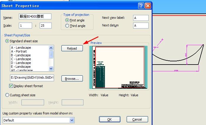

How to reload sheet format?
Reload. If you make changes to the Sheet Format, click to return to the default format.
Sheet Format/Size
Standard sheet size. Select a standard sheet size, or click Browse and locate a custom sheet format file.
Display sheet format. Display border, title block, and so on.
Why use SetTemplateName or SetupSheet4 don't reload the Sheet Format?
               tmpPlateName = oRng
               SwSheet.SetTemplateName tmpPlateName
               SwDraw.SetupSheet4 SwSheet.GetName, 12, 12, 1, oScale, True, tmpPlateName, 0.42, 0.297, "Default" ', True
