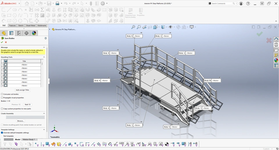

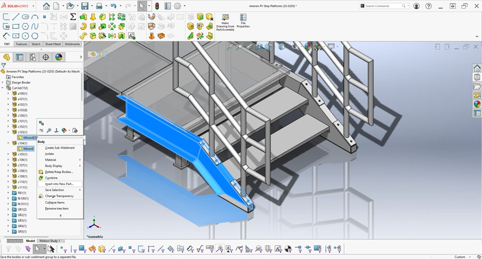

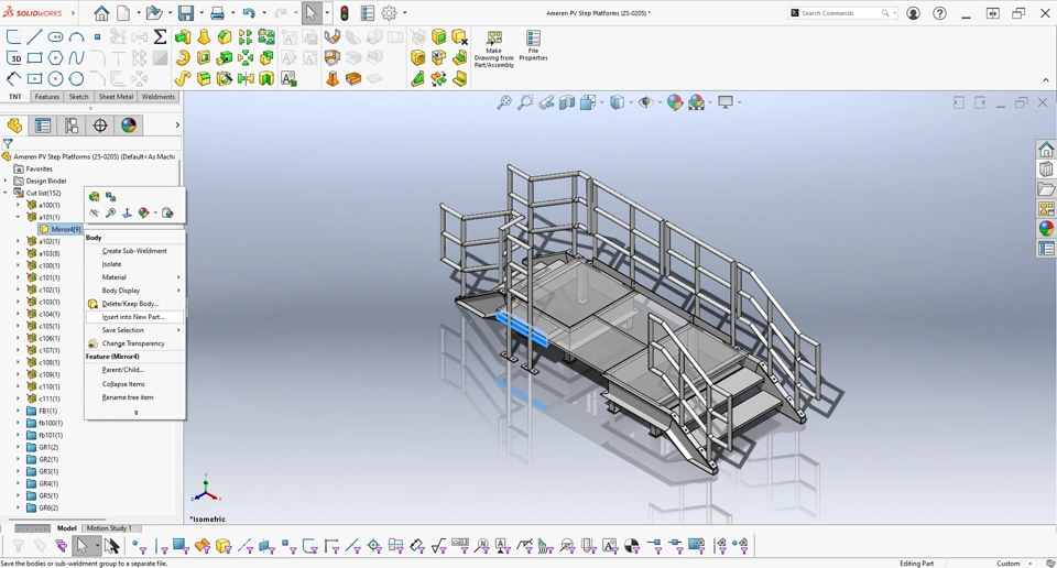

I am a steel detailer and the way that I model a project is that I use one single part file for the entire model. Then when it is ready for fabrication I pull out each individual assembly and part to make each drawing. I go through one by one down the cut list generated in the SolidWorks Part file and right click the body and insert into a new part. Is there a way to insert them all to their individual files with one command or do I have to do them one at a time like I am doing? I noticed if you right click the Cutlist folder and press "Save Bodies" it will allow you to do this but it will not bring the part naming that I have already done with it

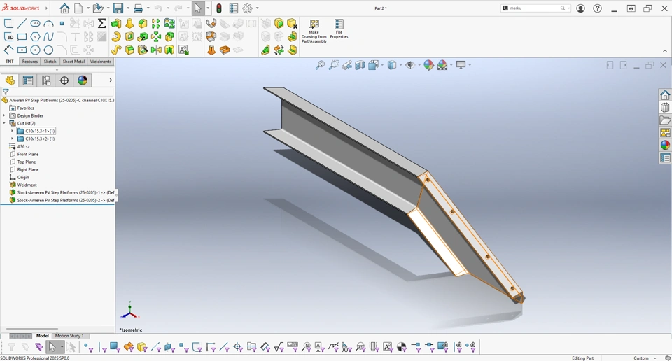

Also whenever I select multiple bodies so I can insert my assembly into a new part it does not bring any of the part naming with it either.
