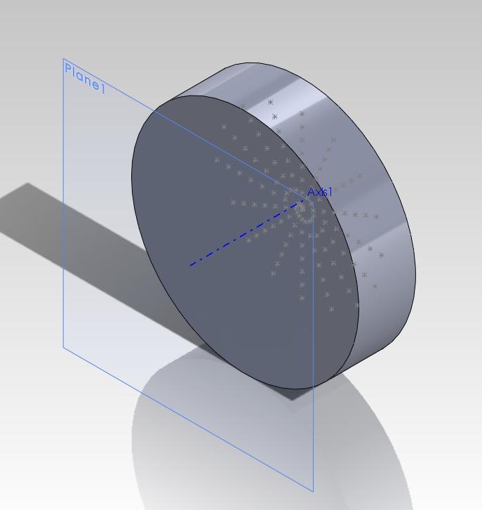

I am new to Solidworks API. I would like to ask how do I write a loop macro for the following:
I currently have 3Dsketch points in the form of an archimedes spiral. What I have done is to create an axis from point to plane as shown.
the macro for creating the axis is as shown:

I noticed that I can draw different axis at different points by changing the Point20@3DSketch19 to for example
Point100@3DSketch19. But I want to run a macro that automatically draws an axis for all the points at the 3DSketch.
I have no idea how to start.
