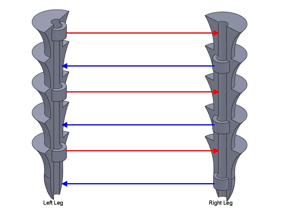

So, the background: I have a "leg" that I'm modeling, which is to be split into 2 pieces, which will then be joined together to form one cohesive leg. The 2 pieces will be joined in a fashion similar to a door hinge application - one side will have "male" protrusions, which will fit into "female" depressions, while the other side will have the same features, just alternated. The leg has a hole through the center where a pin will be placed, running down the hole & through each protrusion, thus holding each side together to the other side.
I modeled it as 1 part, but with 2 configurations (left side, and right side), as can be seen in the attached file: "Barbed_Leg_Configurations.jpg" Each "side" has certain applicable protrusions either suppressed, or unsuppressed, as needed. The file shows the 2 legs, and the arrows show how & where the 2 pieces are to fit each other.
The 1st question is: How can I model the depressions? I know there's a way to take the location, size, and dimensions of the protrusions & use those parameters to create the depressions, but I haven't had the need to perform this type of modeling as of yet, so I'm not sure how it should be accomplished. I also know there's a way to do this such that if I decide to change the dimensions of the protrusions, the depressions should update their dimensions accordingly, such that they are always "relative" to the dimensions of the protrusions.
