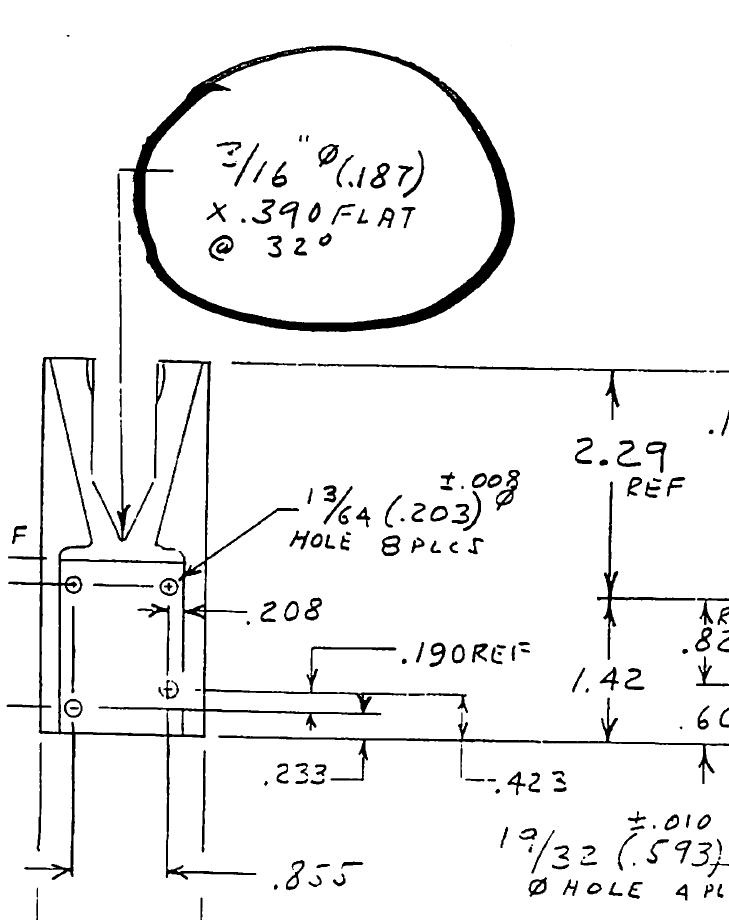

Hi people,
I've attached a drawing PDF, where I've circled the dimensions of the cut that I'm asking about.
I've never seen notation like that, don't know how to interpret and where to place the cut.
Can anyone take a look and help?
Thanks.
