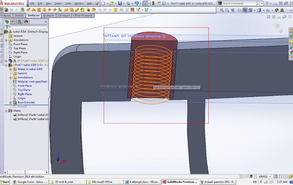

I tried to use different tools to make a cutout on a part with outer threads by the use of a part with inner threads. (Nut "cuts out" threads on a bolt.)

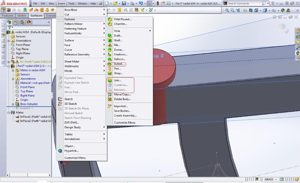

Some of the tools are grayed out.
Why are some tools grayed out? What did I do wrong?

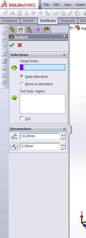

What settings do I use to make a cut out of one shape on another shape with an offset?
Pretty much, I would like to move up a bolt to a part in an assembly, hit a button and get a matching cutout for a thread with an offset so bolt will go in freely. We don't use standard threads sometimes. In this specific part, an extension spring is going to be threaded on to a special thread to hold it in place.
What do indent "parameters" stand for? Should I use Indent?

combine and intersect are only valid for multi-body parts.
use the indent feature when editing a part in an assembly to make a cut-out with an offset.
target body - body that recieves the cut (in the part being edited).
tool body region - parts or bodies that do the cutting.
cut - if checked offset will be 0.00

My computer is slow and indent gets stuck a lot.
What settings do I make to make an indent with an offset?
To cut out a hole in shape of a bolt with a 0,20mm offet.

Also why T1 (whatever it means) gets greyed out with a value when I choose the "cut" checkbox?
