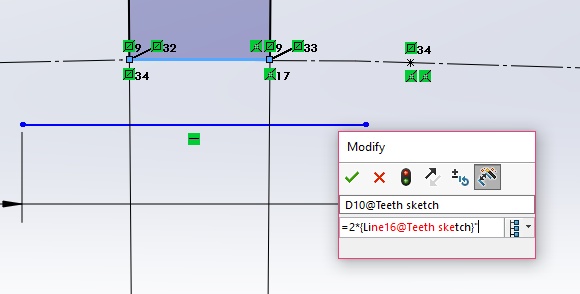

Would like the dark blue line to be twice as long (and midpoints aligned) as the light blue line. I tried the following:
  • Smart Dimension > "2*" + click the blue line
Expected:
A relationship to be formed between the two sketch entities, and the green OK to work.
Actual:
I get this funny black/red equation with a lone quote mark at the end. OK tick does not work, nor give an error.
I then tried:
  • removing the lone quote
  • adding a quote just after "2*"
  • renaming the sketch so there's no space in its name
None of these mattered.
Is this a bug?
How would you form such an innocent-looking relation between two sketch entities?  (Limitation: I don't want to add a global variable for this.)
