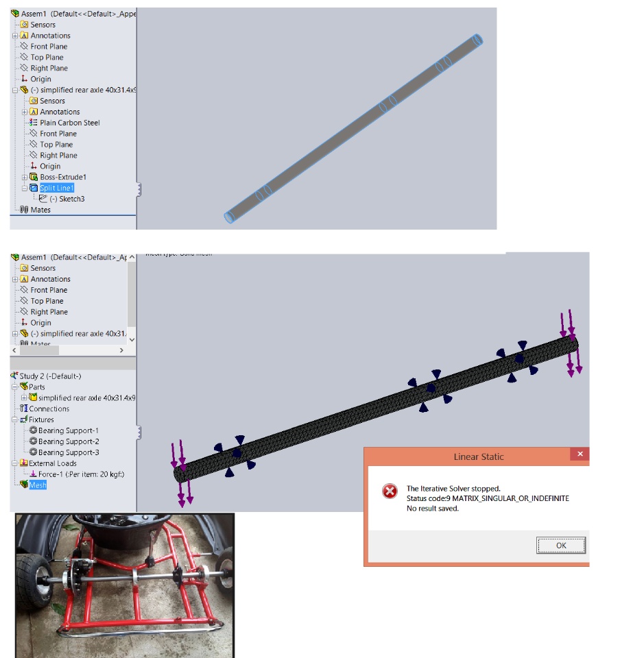

Hi,
As a starter project (SW2010), I am trying to make a crude simulation of a Go Kart rear axle flex when using a combination of 3 bearing supports (see pic below).
For that matter I use the "bearing" fixtures and apply a force at the extremities of my axle
Should be quite simple, yet I keep getting  the " model is unstable..." error when using "direct sparse" solver  or "status code 9 : matrix singular.."  when using the "FFEplus"solver
I must be missing something very obvious. Could someone shade a light on this or suggest  a relevent reference document/video tutorial for axle/bearing simulationst?
Thanks in advance for your help,
SolidworksSimulation

BW 2013-10-01 Best Answer
Your model is underconstrained.  Particularly in axial translation and rotation.  Think about the real life problem - you have at least one constraint in the axial direction with a shaft clamp, circlip, or something and you have rotational constraint with either the brake applied or the torque to the drive sprocket.  Add in the additional constraints and it should solve fine.  Be sure to check your solution with some simple beam calculations.

SF 2013-10-01
Slam dunk billy. The other thing is that you're making the assumption that the loading is perfectly balanced and hat the shaft won't rotate. Because the mesh isn't perfect, numerically it won't be stable. So you will also need to constrain rotation in at least one place. There are a bunch of threads about bearings that you can learn more about this. No specific tutorials unfortunately.

SF 2013-10-02
BiIly and Jared, thanks for the explanation.
Btw, I came across another forum thread suggesting to use "inertial relief" to cancel instabilities due to mesh imperfection. Would this make sense for me to use this option or should I definitely try to add some explicit constraints to prevent shaft rotation/translation as per Billy's suggestion.

BW 2013-10-02
If you were to constrain one node to stop rotation and axial translation, then the results should be the same as with inertia relief enabled.  If you were to constrain the part as it is with circlips/shaft clamps, and the sprocket/rotor interface the results would likely be a bit different, but also more applicable to the actual situation.  I only use inertia relifef when there is no other reasonable option to stabilize the model.

SF 2013-10-03
Adam, read though a few more posts on inertial relief, really for troubleshooting only. High chance of affecting the results and making them whacky. Better to restrain properly.
